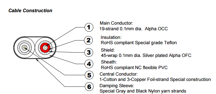

а вот что про конструкцию пишут другие (обращать внимание на выделенные фрагменты):
Sennheiser HD800
Features
-OCC material used to minimise transmission loss.
-Plug the non-magnetic rhodium plating process.
-Housing features carbon fiber on the non-magnetic stainless steel material.
-Sheath of RoHS directive conformity reduces external noise.
* Main conductor is Furutech a (Alpha) process ( low-temperature process at-196 ° c & special electromagnetic process ) to reflect.
Specifications
-Main conductor: 19 this x 0.1 mm a--OCC
-Insulation: RoHS directive conformity スペシャルグレードテ CFC
-Shield: 45 × 0.1 mm silver plated Alpha-OFC
• Sheath: RoHS directive conformity flexible PVC
And the Center conductor: cotton 1 / copper foil twisted wire 3 book special structure
-Control damper sleeve: special nylon yarn stranded
http://www.avcables....-35Hx Cable.pdf
Изменено пользователем Surgut2006
