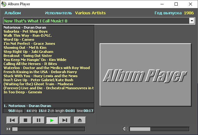

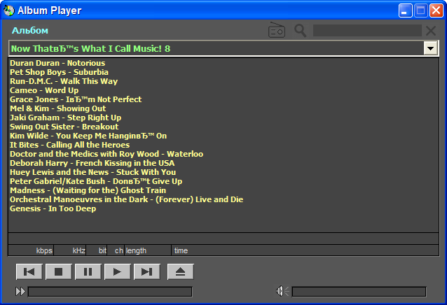

Игорь, такой cue не обрабатывается, вместо него в плейлист затягивается только имя самого flac образа.
REM GENRE Pop
REM DATE 1986
REM DISCID FC102211
REM COMMENT "ExactAudioCopy v0.99pb5"
PERFORMER "Various Artists"
TITLE "Now That’s What I Call Music! 8"
FILE "Various Artists - Now That’s What I Call Music! 8.flac" WAVE
  TRACK 01 AUDIO
    TITLE "Notorious"
    PERFORMER "Duran Duran"
    INDEX 00 00:00:00
    INDEX 01 00:00:33
  TRACK 02 AUDIO
    TITLE "Suburbia"
    PERFORMER "Pet Shop Boys"
    INDEX 00 04:00:25
    INDEX 01 04:01:30
  TRACK 03 AUDIO
    TITLE "Walk This Way"
    PERFORMER "Run-D.M.C."
    INDEX 00 08:04:23
    INDEX 01 08:05:13
  TRACK 04 AUDIO
    TITLE "Word Up"
    PERFORMER "Cameo"
    INDEX 00 11:45:45
    INDEX 01 11:47:28
  TRACK 05 AUDIO
    TITLE "I’m Not Perfect"
    PERFORMER "Grace Jones"
    INDEX 00 16:05:73
    INDEX 01 16:07:13
  TRACK 06 AUDIO
    TITLE "Showing Out"
    PERFORMER "Mel & Kim"
    INDEX 00 19:27:50
    INDEX 01 19:28:58
  TRACK 07 AUDIO
    TITLE "Step Right Up"
    PERFORMER "Jaki Graham"
    INDEX 00 23:02:28
    INDEX 01 23:03:43
  TRACK 08 AUDIO
    TITLE "Breakout"
    PERFORMER "Swing Out Sister"
    INDEX 00 27:02:28
    INDEX 01 27:03:30
  TRACK 09 AUDIO
    TITLE "You Keep Me Hangin’ On"
    PERFORMER "Kim Wilde"
    INDEX 00 30:50:35
    INDEX 01 30:51:40
  TRACK 10 AUDIO
    TITLE "Calling All the Heroes"
    PERFORMER "It Bites"
    INDEX 00 35:02:68
    INDEX 01 35:04:08
  TRACK 11 AUDIO
    TITLE "Waterloo"
    PERFORMER "Doctor and the Medics with Roy Wood"
    INDEX 00 39:06:53
    INDEX 01 39:07:45
  TRACK 12 AUDIO
    TITLE "French Kissing in the USA"
    PERFORMER "Deborah Harry"
    INDEX 00 42:31:45
    INDEX 01 42:33:03
  TRACK 13 AUDIO
    TITLE "Stuck With You"
    PERFORMER "Huey Lewis and the News"
    INDEX 00 46:44:45
    INDEX 01 46:45:65
  TRACK 14 AUDIO
    TITLE "Don’t Give Up"
    PERFORMER "Peter Gabriel/Kate Bush"
    INDEX 00 51:10:18
    INDEX 01 51:11:20
  TRACK 15 AUDIO
    TITLE "(Waiting for the) Ghost Train"
    PERFORMER "Madness"
    INDEX 00 56:51:13
    INDEX 01 56:52:23
  TRACK 16 AUDIO
    TITLE "(Forever) Live and Die"
    PERFORMER "Orchestral Manoeuvres in the Dark"
    INDEX 00 60:34:65
    INDEX 01 60:36:50
  TRACK 17 AUDIO
    TITLE "In Too Deep"
    PERFORMER "Genesis"
    INDEX 00 64:09:33
    INDEX 01 64:11:05
Изменено пользователем AleXH
Видимо, файл flac иначе назван.
Если я называю файл
то всё нормально затягивается:
Именно так и назван - скопировал его имя и вставил в куе, сверил, 1-в-1. Обработка cue включена.
"Various Artists - Now That’s What I Call Music! 8.flac" это из поля  переименования в FAR
Я тоже в FAR переименовывал, и в Windows 10 всё открывается. Возможно, код апострофа “плавает” где-то, тогда попробовать без него.
Только я из CUE в FLAC переносил.
Изменено пользователем IgorA

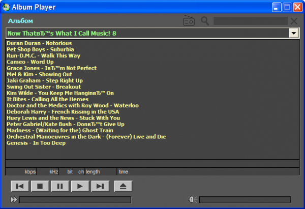

Да, дело в апострофе 2019h, он несколько раз в cue (кодировка UTF8) встречается. Имеем: FAR файлы с ним открывает нормально, АР нет (ХР). Удалил апостроф в имени флэка и в куе. Апостроф в остальных местах отбражается так:
Почти наверняка, проблема в том, что файл cue в utf8, а плеер по умолчанию открывает его как windows-1251, что делается из-за наличия большого числа русских cue в этой кодировке. Скорее всего, достаточно было бы пересохранить исходный cue в Блокноте с кодировкой utf8. При этом в начало файла добавится маркер кодировки и плеер будет открывать его как utf8.
Добавил BOM, АР открыл его корректно, спасибо.

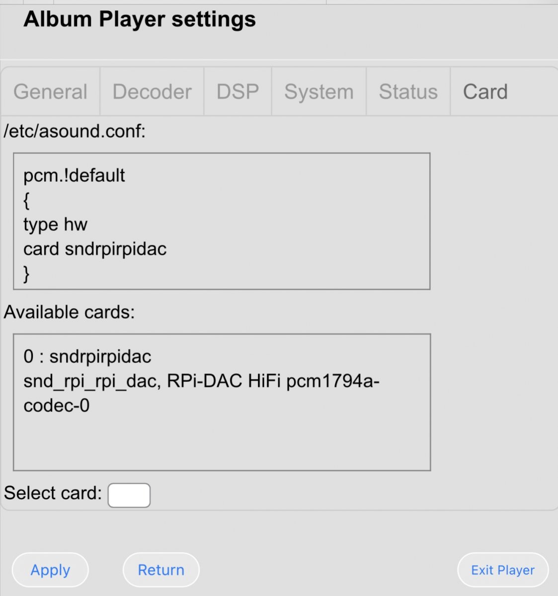

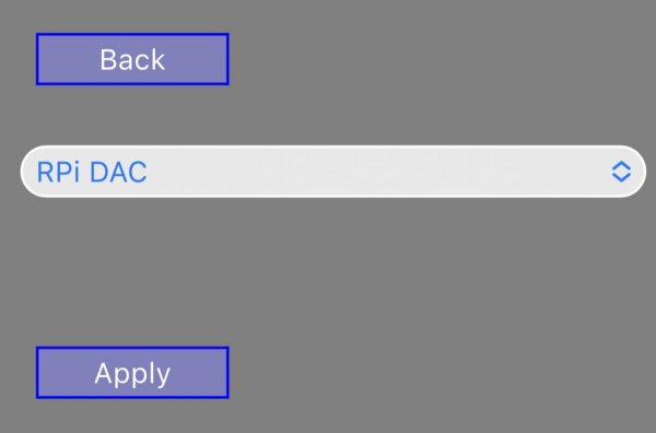

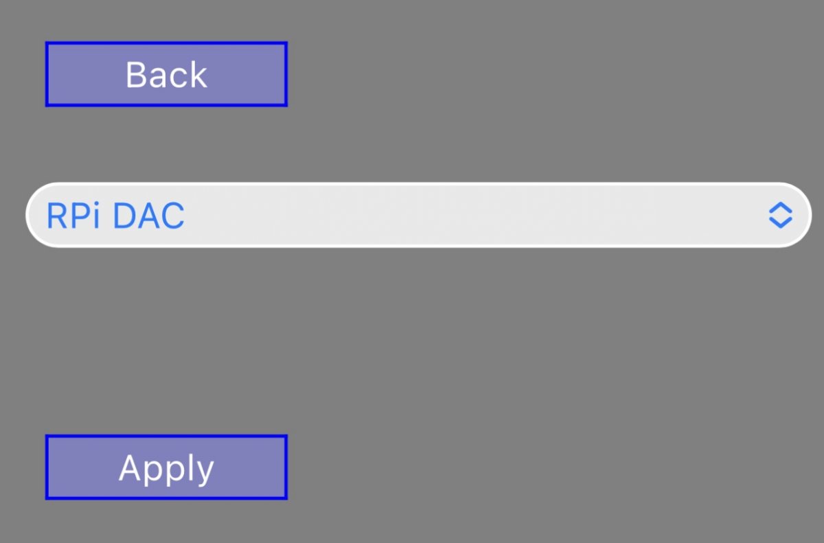

В 30.12.2022 в 15:03, IgorA сказал:
Но я I2S вообще не занимался, поэтому посоветовать конкретный вариант решения не могу.
Игорь, приветствую!
Я нашел ответ- при подключении RPI к цап по I2S надо в APmenu выбрать устройство вывода RPI DAC
а в настройках плеера то, что найдет плеер, у меня так
Спасибо за софт!
