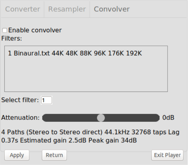

What are the exact requirements for the wav correction files used in the convolver for Linux?
Under Windows I just have a folder with correction files [44]xxx.wav, [48]xxx.wav etc.that I can load in the VST tab.
But I believe it is different for Linux?
Изменено пользователем bodiebill
The filter files in Windows and Linux are the same. Under Linux the files for the convolver must be placed in the 'cfilters' folder, which is a subfolder in the player folder (and in the renderer folder).
The filter file is then selected on the 'Convolver' tab.
hi Igor, it works now. I just put all the wav files in the cfilters directory.
I keep coming back to this player, thanks!
