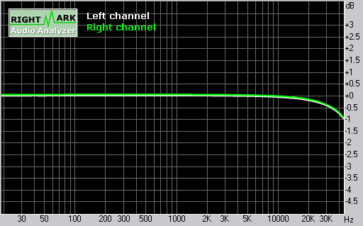

015F RightMark Audio Analyzer test
Testing chain: External loopback (line-out - line-in)
Sampling mode: 24-bit, 192 kHz
Summary
Frequency response (from 40 Hz to 15 kHz), dB: +0.01, -0.11 Excellent
Noise level, dB (A): -102.6 Excellent
Dynamic range, dB (A): 101.8 Excellent
THD, %: 0.0046 Very good
IMD + Noise, %: 0.0054 Excellent
Stereo crosstalk, dB: -96.7 Excellent
IMD at 10 kHz, %: 0.0063 Excellent
Detail^^^^^
Frequency response
Frequency range Response
From 20 Hz to 20 kHz, dB -0.18, +0.01
From 40 Hz to 15 kHz, dB -0.11, +0.01

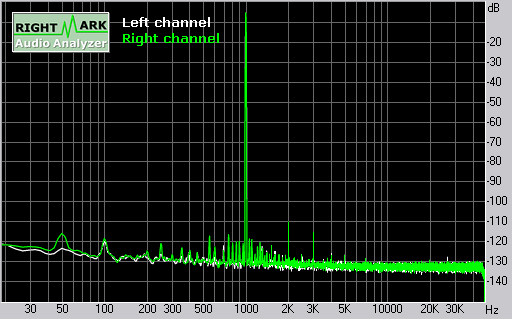

Noise level
Parameter Left Right
RMS power, dB: -100.7 -98.4
RMS power (A-weighted), dB: -102.6 -101.7
Peak level, dB FS: -75.4 -74.9
DC offset, %: -0.00 0.00
Dynamic range
Dynamic range, dB: +100.4 +98.2
Dynamic range (A-weighted), dB: +102.5 +101.8
DC offset, %: 0.00 -0.00

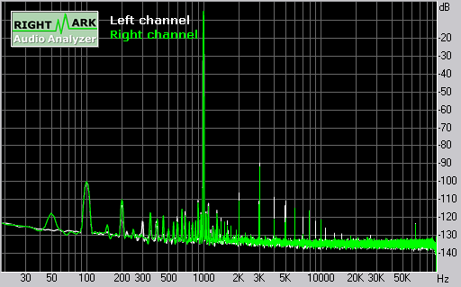

THD + Noise (at -3 dB FS)
THD, %: 0.0059 0.0046
THD + Noise, %: 0.0065 0.0055
THD + Noise (A-weighted), %: 0.0082 0.0065

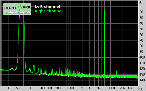

Intermodulation distortion
IMD + Noise, %: 0.0066 0.0054
IMD + Noise (A-weighted), %: 0.0047 0.0040
Stereo crosstalk
Parameter L <- R L -> R
Crosstalk at 100 Hz, dB: -90 -84
Crosstalk at 1 kHz, dB: -95 -96
Crosstalk at 10 kHz, dB: -86 -96

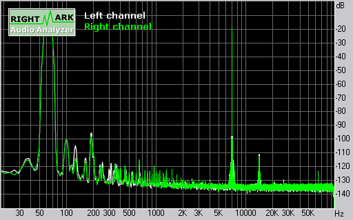

IMD (swept tones)
IMD + Noise at 5 kHz, %: 0.0073 0.0057
IMD + Noise at 10 kHz, %: 0.0057 0.0054
IMD + Noise at 15 kHz, %: 0.0067 0.0078
Как видите, те же самые 9-15дБ хуже по ТДХ, чем TDA154x, только это на 192кГц. На 44100 наш 015F во столько же раз лучше TDA154x в голом виде. Обвязка её сколько добавит?. Музыку можно слушать))
