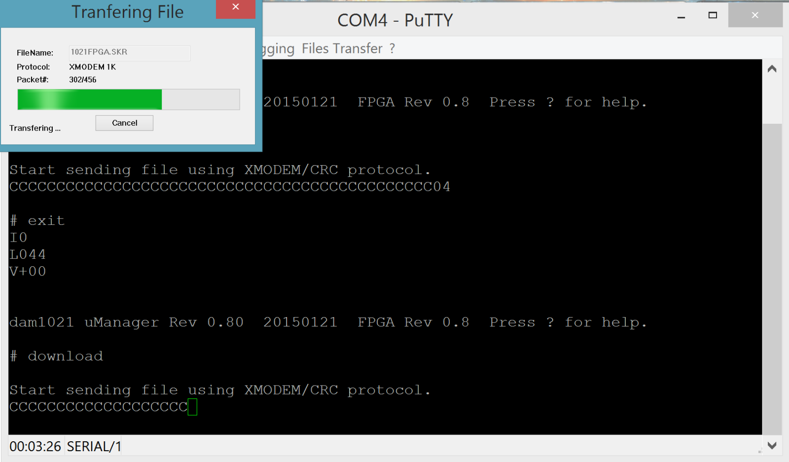

The Soekris R2R board has a built-in uManager, whereby user may program / parameterize the DAC setting (particularly the Filters) to obtain the desire sound by changing the filters selection. The RS-232 serial port is available at the rear panel, you'll need the following to get into the uManager:
1. Computer (Windows based preferred)
2. USB to RS-232 Converter (most computer nowadays doesn't come with this port, you will need a converter)
3. ExtraPutty Software: Link here
4. Filters file compiled by others (or you may compile your own if you know some software skill!)
There are details guide all over the internet to guide you how to connect the computer to the Soekris DAC. I'll just point out a few key steps:
1. Connect USB to RS-232 Converter to the computer
2. In Device Manager, configure the RS-232 port baud rate etc to (115200, 8, n, 1), take note of the COM port #
3. Connect the RS-232 to the RS-232 port at the rear panel of the DAC
4. Power On the DAC
5. Launch ExtraPutty, select Serial connection, the COM port and key in the baud rate, then click Open
6. The following screen will be shown:
7. Type "+++" (the command to call out the uManager), the command line manual will be shown:
8. Now, you'll see the firmware of the Soekris DAC. All DAC is shipped with latest firmware v1.06
9. Have your desire firmware/filter files ready, key in "download" on the cmd line screen
10. While the download is waiting for a file to be transfered, in ExtraPutty windows, select File Transfer -> Xmodem 1K -> Send. Browse to the firmware/filter file, and you're ready to transfer!
11. When the transfer is completed, you'll see the following display:
12. Type "Set Filter" to change the type of filters. In general, you can choose the following. It depends very much on the type of filter file you loaded to the Soekris DAC. T
