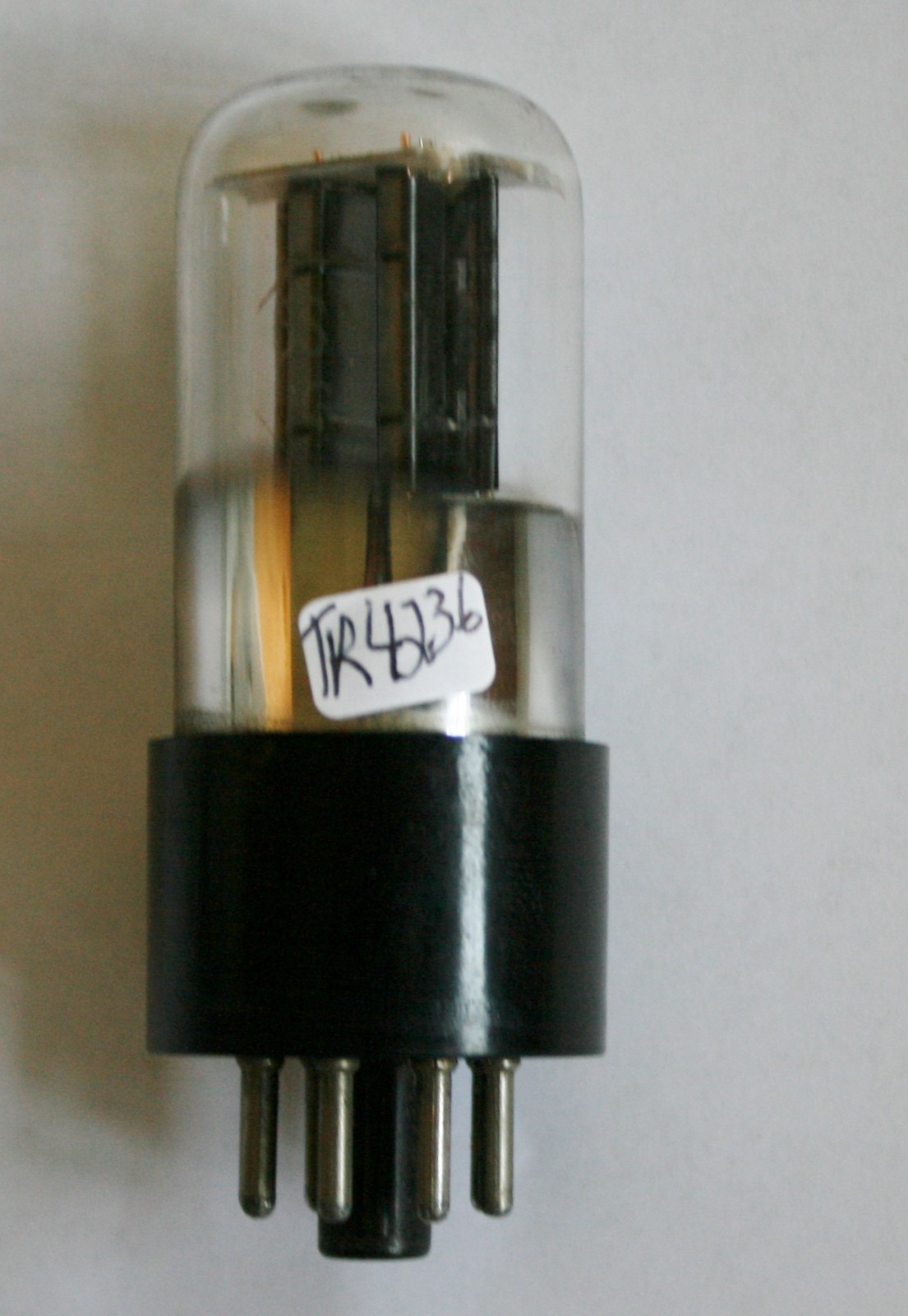

Вот эта затёртая 6SN7GT,без названия, похожа на Bad Boy? Вроде на верхней пластине есть зубчики? Фотка одна и плохая.
Да Вы правы - это "Bad Boy" 1950 года, лампа немного Б/У.

Вот описание Bad Boy:
1. Made by Sylvania, although they can be relabeled / rebranded by a number of other companies, like RCA, Philco, Westinghouse, etc.
2. Are made between very late 1951 and very early 1953.
The first digit of the date code represents the year, and needs to start with a 1, 2, or 3. The 1, 2, or 3 may be underlined. If it was made in 1950 it is NOT a Bad Boy.
3. Have a BOTTOM foil getter. Flashing can extend up to 1/3 of the way up the tube, from the bottom. If it has a chrome top, it is NOT a Bad Boy type tube. Bad Boys ALL have clear glass on top.
4. The TOP mica is rectangular, with 3 spikes on each of the shorter edges. These three spikes look like small triangular edges bent down on each side. If there are no spikes, it is not a Bad Boy.
5. The BOTTOM mica is rectangular
6. Have opposing black T-plates
7. Has a black base
8. Has copper grid posts
9. Have three rivet holes (like the one I am selling.) There is debate on this issue, but on another website, someone disassembled the two and three hole tubes to document the internal differences.
10. Are ONLY a 6SN7GT tube type. Not a 6SN7GTA or 6SN7GTB.
11. Are NOT labeled VT231, which looks very similar, but were made earlier.
(Still great tubes, but lack the bass of the Bad Boy types.)
However, military tubes marked JAN-CHS-6SN7GT CAN be real Bad Boys.
For reference, here is a picture of a real Bad Boy (left) vs. a NON-Bad Boy:
Note: Number of holes in plate, lack of spikes on top mica. The difference is in the details.
