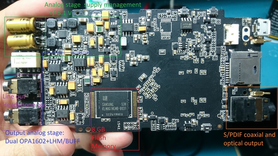

The DX80. MORE DETAILS POSTED REGULARLY. Release date to be announced.
*Si TIme MEMS Oscillator X2
*XMOS USB receiver with Thesycon USB Audio driver. Easy to use USB DAC.
*Line out has a set voltage.
*Dual CS4398 dacs and native DSD.
*Dual micro SD slots.
*3600mah battery.
*Optical and coax digital output.
*3.2 inch screen with a resolution of 480*800 IPS screen.
*Native DSD64 and 128 from SD card or USB input.
*Line out:Output Level: 1.6Vrms (1kHz0dB)
--Frequency Response:17Hz ~20KHz +/-0.1dB
--S/N:-116dB +/-1dB
--THD+N: 0.001% Crosstalk: 107d B (1KHz)
*Headphone out: Output Level: 2.9Vrms(32ohm Load).
*260mW into a 32 ohm load.
--FrequencyResponse: 17Hz~20KHz +/-0.1dB
--S/N: -114dB +/-1dB (32ohm Load)
--THD+N: 0.002% (32ohm load)
*Output Impedance: <0.1ohm
*Size: 120mm*63.2mm*16.8mm
*Weight: 178g
**Retail price: $359.00
