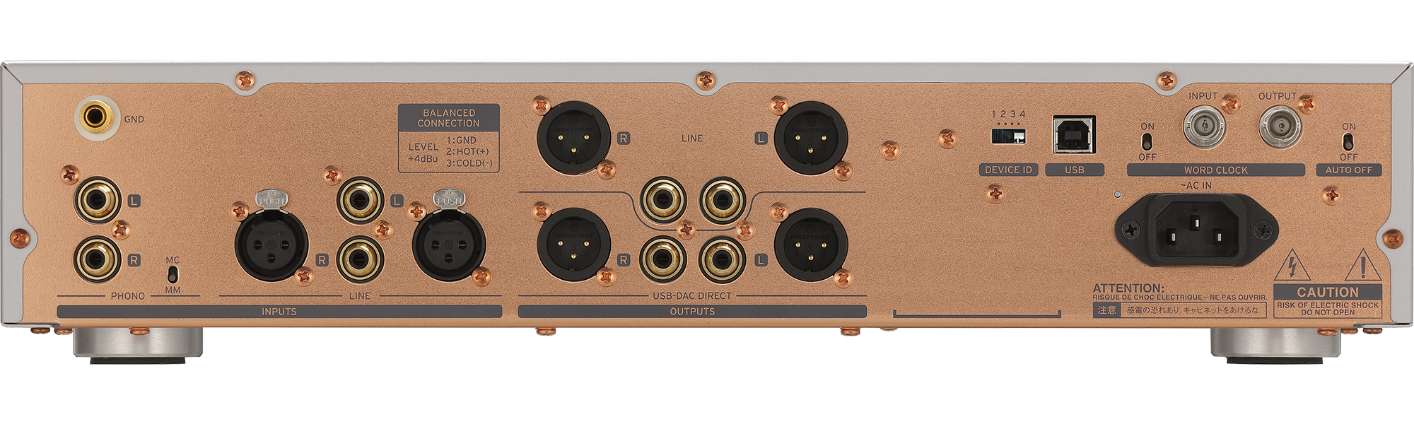

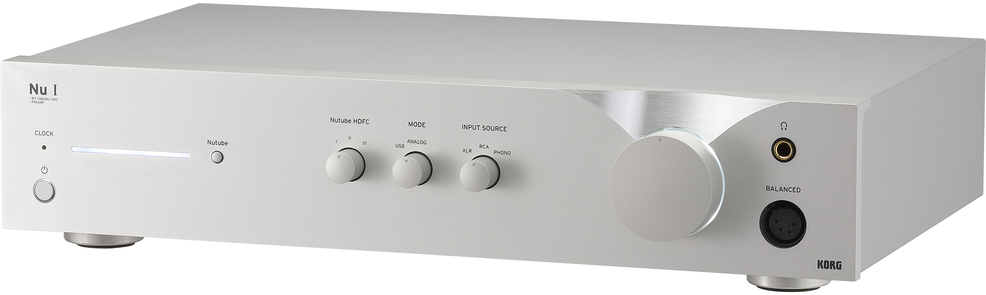

В октябре выходит новая звуковая карта от Корга Nu I. Для записи и воспроизведения вплоть до DSD 11.2 MHz. На АЦП микросхеме AK5574 и ЦАП AK4490. Можно объединять до 4 устройств для 8-канальной записи. С дозируемым (You can also adjust this harmonic amount as desired by the newly developed Nutube HDFC - Harmonic-Detecting Feedback Circuit) ламповым предусилителем.
Сам пока не слышал, отпишусь позже.
Number of channels 2 channels
Supported format (USB) DSD : 2.8224 MHz / 5.6448 MHz / 11.2 MHz, 1 bit
DSD : 3.072 MHz / 6.144 MHz / 12.288 MHz, 1 bit (only when using SONIC remastering technology)
PCM : 44.1 kHz / 48 kHz / 88.2 kHz / 96 kHz / 176.4 kHz / 192 kHz / 352.8 kHz / 384 kHz, 16 bit / 24 bit
Host interface USB 2.0 (high speed), isochronous asynchronous transfer
Audio Driver ASIO 2.1, WDM, Core Audio
General indicator STANDBY / ON, CLOCK, NUTUBE ON / OFF, DSP / PCM mode indication
Automatic power off No operation for 30 minutes or no input (MODE = ANALOG and AUTO OFF SW = ON)
Power supply AC 100V power consumption 40 W
External dimensions 432 (W) x 282 (D) x 93 (H) mm (including projections)
mass 5.9 kg
Main standard
Frequency characteristic 10 Hz to 80 kHz -3 dB (@ USB - DAC DIRECT)
10 Hz to 20 kHz ± 1 dB (@ fs = 44.1 kHz / 48 kHz)
Dynamic range 120 dB (TYP.) @ 20 Hz to 20 kHz
Vacuum tube Nutube 6P1 x 2
connector INPUTS LINE L, R Shape: XLR-3-31 (1: GND
, 2: HOT, 3: COLD), BALANCED defined input level: + 4dBu (1.23Vrms)
Maximum input level: + 20dBu (7.75Vrms) :( 0dBFS , 0dB-SACD)
Input impedance: 22 kΩ
Shape: RCA pin · Jack
Specification Input level: -6 dBV (0.5 Vrms)
Maximum input level: +6 dBV (2.0 Vrms): ( 0 dBFS, 0 dB - SACD)
Input impedance: 50 kΩ INPUTS PHONO L, R Shape: RCA pin jack
Nominal Input Level: 0.3mVrms@1kHz (MC) / 5mVrms @ 1kHz (MM)
Maximum input level: 5.0mVrms@1kHz (MC) / 50mVrms @ 1kHz (MM)
input impedance: 220Ω (MC) / 50 kΩ (MM) OUTPUTS LINE L, R / USB-DAC DIRECT L, R
Shape: XLR-3-32 (1: GND
, 2: HOT, 3: COLD), BALANCED nominal output level: + 4dBu (1.23Vrms)
maximum output level: + 20dBu (7.75Vrms) :( 0dBFS , 0dB-SACD)
load impedance: 600 ohms or more
shape: RCA pin jack
Nominal output level: -6dBV (0.5Vrms)
maximum output level: + 6dBV (2.0Vrms) :( 0dBFS , 0dB-SACD)
load impedance: 47kohm more
PHONES :
BALANCED
Maximum output level: 500 mW + 500 mW @ 60 Ω, 300 mW + 300 mW @ 300 Ω
Load impedance: XLR-4-32 (1: L +, 2: L-, 3: R +, 4: R-, screen: GND) 32Ω or more
φ6.3mm stereo phone jack
maximum output level: 400mW + 400mW @ 32Ω
load impedance: 16Ω more
WORD CLOCK IN / OUT Shape: BNC receptacle, 75 Ω
USB (device) Shape / Format: Type B / USB 2.0 compliant High Speed
Supported OS Microsoft Windows 10 (32 bit, 64 bit), Mac OS X 10.11 El Capitan or later
accessories Power cord, USB cable

Опубликовано
Когда в KORG утомились наблюдать отсутствие интереса к своей любимой плоской лампе, им наконец вспомнилась: "сам себя не похвалишь – никто не похвалит". Ведь это, кажется, их первый собственный продукт на 6P1, нацеленный на бытовое использование.

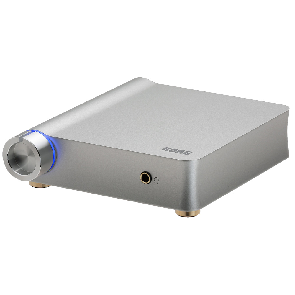

@GrigoriySB, про DS-DAC-10R: https://www.korg.com...dio/ds_dac_10r/ уже слышали?
Система: ПК(Рабочая станция) -> (via Wi-Fi) -> NAA -> ЦАП DSC2 -> Beta22 -> Phonon SMB-02 (персональный MOD) или Sennheizer HD800 (персональный MOD). Портатив: QLS QA360 -> Phonon SMB-02.

уже слышали?
Конечно, он можно сказать старичок.

@GrigoriySB, по-моему он и является родоначальником нового стиля KORG.
Возможно. Просто хочется аппарат между этими двумя моделями по функционалу, как то так.
А чего вам не хватает в 10R? Он ведь тоже писать умеет.

В коротком ревью от fujiya-avic промелькнула цена заявленная производителем: 何と、メーカー標準価格は税込 459,000円 というハイクラスどころかハイエンドクラスの1bit DAC / ADC内蔵ヘッドホンアンプ(と、とりあえず呼ばせて頂きます)兼プリアンプ。- если ориентироваться на их предыдущую продукцию, значит через год после релиза будет в половину... Но всё равно совсем иная ценовая ниша.
Интерес есть, но лампа то не аудиофильская, а меломанская и музыкантская. Так что если её ставят в аудиофильские устройства, то всегда с возможностью обойти когда не нужно.

@PA3BPAT, речь шла о внешнем стиле. По-моему сходство есть.
post-22812-0-68464900-1536745812_thumb.jpgpost-22812-0-67199100-1536745822_thumb.jpgpost-22812-0-89936300-1536745836_thumb.jpg
