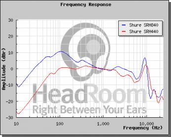

@oifunza, я их, увы, не слушал. Но если судить по ачх, то у 840 баса значительно побольше, и чуть побольше верхов.
Также можете почитать тему на хедфае (https://www.head-fi....erences.454205/)
"For classical music the 840s will outperform the 440s. They are much more detailed and the sound is much more separated, allowing you to hear separate instruments much more clearly."
"The 840's have been said to have a more detailed top end and also better sound separation/increased headstage, overall. They seem remarkably open for closed cans such a low price-point. Generally an improvement over the 440's SQ in all areas, if you have a decent amp."
